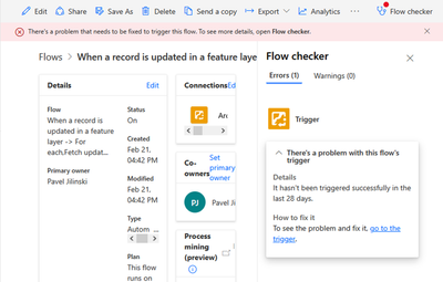

I opened the Flow and made sure the connections were good and saved it. At the top of the Flow, it stated that it was ready to go (see the attachment called Save_Successful.png). Then, when I returned to the Flow's management page, it gave me an error (see the Flow_Checker_Error.png attachment). I then clicked on the "Go to the trigger" link and the Run Details stated that there was an "Error creating webhook" (see attachment called "Error_Creating_Webhook.png). I did a bit of research and found that I didn't have the "Keep track of changes to the data" setting turned on. After I updated this setting in ArcOnline, the Flow triggered. However, the conditions were set incorrectly so the Flow didn't complete. I updated the conditions and the next time I updated the attribute to trigger the Flow, it failed (see the Flow_Fail.png screenshot). The "For Each" actions wouldn't stop spinning so I can't see what the error is there. I also don't know why there are so many "For Each" actions; they just keep getting added when I added other actions to my Flow.
