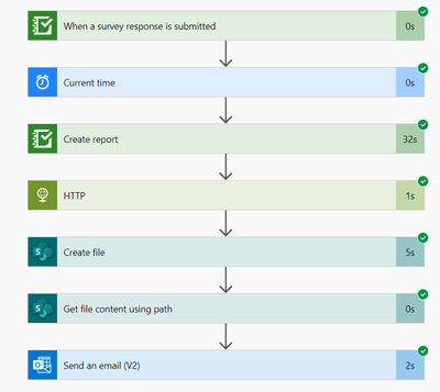

My flow with the HTTP request actually directly uploads the created report to SharePoint, so it's an alternative approach to the method you show above. Here's my general flow:

Hi Sean,
Wondering if this method still holds up. I tried to implement the same steps but get the following error:
Action 'HTTP' failed: Unable to process template language expressions in action 'HTTP' inputs at line '0' and column '0': 'Required property 'uri' expects a value but got null. Path ''.'
For context, I am using the ArcGIS for Enterprise connectors and the URI in the HTTP action is that of the first result for the Get Report Action.
Any help is greatly appreciated!

@SeanKMcGinnis  / @Tiff ,
Are these flows still working for you? I found this suggestion on another thread a little while ago and it had been working great. Unfortunately the PDFs in SharePoint are coming in empty now. It looks as if they are there, but the files are only 1KB now.

@Beard_Greg - I am testing a number of different flows in support of UC presentations and am having no issues.

Thanks for the quick reply. I'm not sure why it isn't working for me. I'm rebuilding using the ESRI's "Get Attachment" instead of using the HTTP. That seemed to have resolved my issue.
