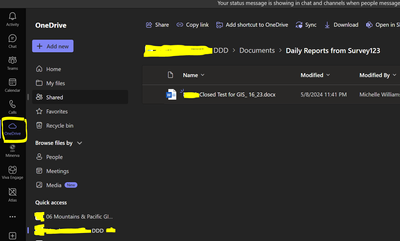

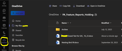

Thank you, I went into TEAMs and there are two types of folders:
~ OneDrive | My Files (this one works)
OneDrive | Quick Access (in SharePoint - This one is broken)
@Beard_Greg and Robert are you seeing something different on your end?

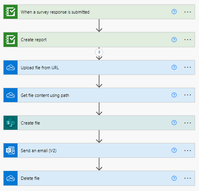

I might not be following along. In the solution, we have it first going to OneDrive then moving it to SharePoint, and then deleting the file in OneDrive. It sounds like your OneDrive link is there, but your SharePoint link isn't (kind of the opposite of what you would actually want out of this flow)?
MichelleWilliamsERM
@Beard_Greg Thank you, and I found the issue and I'll share it here for anyone who gets a new computer.
This is a device issue on my new laptop, after having the same issue when I tried to download a WORD feature report template from AGOL I thought I should try my other laptop, and it works fine over there.

You can have more than one webhook going to Survey123. I recommend going to https://survey123.arcgis.com/ --> Settings --> Webhooks and then naming your webhook so you don't get confused later on.
Then go into Power Automate and create a copy of your existing flow so you do not damage your original. You'll notice it added a second webhook (might be worth naming this too). You'll have to rebuild some but shouldn't have to start from complete scratch. You'll just have to update your variables.
