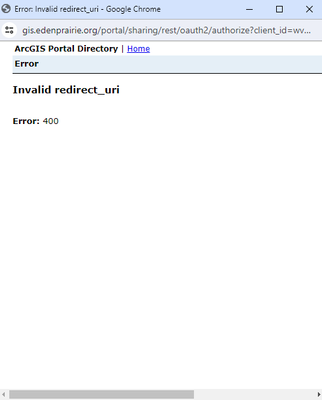

Has anyone else gone through the connection setup and run into the Invalid redirect_uri?
I've created the application in portal and added the redirect URIs as noted here in the documentation
https://doc.arcgis.com/en/microsoft-365/latest/power-automate/set-up-the-arcgis-enterprise-connector...
Anything I'm missing?

PatriceLabbé
Did you accidentally use http(s):// ?

At first, but then I noticed the warning to omit it and did so. That screenshot shows after removing it.

@ZachBodenner - Thank you for reaching out on this issue and posting a screenshot. Our documentation is slightly out of date as the deployment of the connector and our documentation is slightly out of sync.
Can you add the following URLs to your Redirect URL list? Let me know if this solves it!
        https://global.consent.azure-apim.net/redirect/arcgisenterprise
        https://global.consent.azure-apihub.us/redirect/arcgisenterprise

That solves the issue thanks Anthony!
