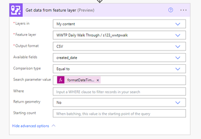

I would like to get data based on date.  I have thought of two methods but have yet to test them out and think there must an easier day.  Here are my methods:
1. Using Available Fields to compete the date field with a unix time stamp.
2. Using the Where clause to filter through all records and get my results.
I would think there would be a more streamline way to retrieve records by date - get todays records.
Any ideas?  Thanks!

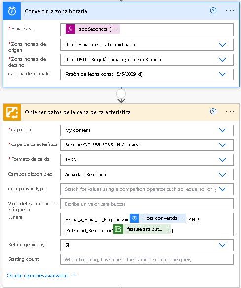

SeguridadSPRBUN
Puedes utilizar la opción "where" colocando esta exprecion
EditDate>='@{body('Convertir_la_zona_horaria')}' AND (Actividad_Realizada='@{triggerOutputs()?['body/feature/attributes/Actividad_Realizada']}')Usando el Where.jpg
