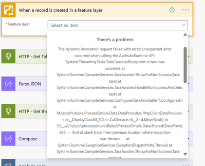

We are experience similar issues.  Last week it was just the Fetch Updates action would completely stall.  This week it still stalls but now our webhooks don't work either.  It would be great if we could at least get an acknowledgement of these issues.  We've been resorting to using the REST API via the HTTP action, which is blazing fast for querying and updating data, but to replicate a webhook looks to be quite complicated.  See attached image.
TL2
I started getting this today too.
