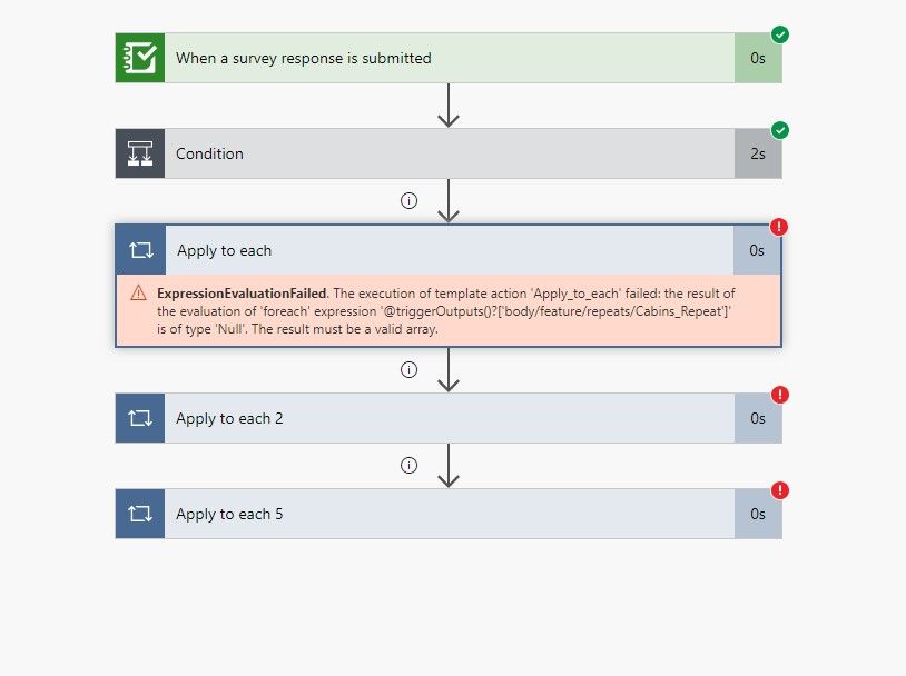

Hello, I am pretty new to Power Automate integration with Survey123 results.
The idea is to have a conditional trigger to add a row in an online excel table for survey repeats that answer 'yes' to a 'select_one yes_no' entry. When setting the condition within an 'Apply to Each' box the submission fails if a repeat is not given a value or a 'null' entry. These are not required sections of the survey and so they are sometimes left blank.
Hopefully this is a simple fix, but I am not sure what needs to be done to allow the flow to continue to the next section without failing. No excel entry is needed when the repeat is has no data.
Any guidance would be greatly appreciated!
DillonShea
For now, I seemed to have resolved this by selecting subsequent triggers to run whether the previous trigger succeeds or fails using the 'configure run after' options. If anyone has a more ideal way to handle this, I would love to hear.
RobertAnderson3
MVP Regular Contributor
The way I end up handling this is by using a Conditon around the Apply_to_each and have it set to check if the repeat is null and then only run the Apply_to_each if it has a value in it.
In mine the dynamic content shows feature repeats Vehicle, that gives me triggerOutputs()?['body/feature/repeats/vehicle_repeat'] when I hover over it after selecting it. Or it might show triggerBody()?['feature']?['repeats']?['vehicle_repeat'] when selected from dynamic content.
So with yours I assume it's just replace vehicle with Cabins.
