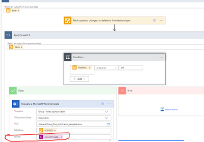

This is what I am using from a Fetch update:
convertTimeZone(addSeconds('1970-1-1', Div(items('Apply_to_each_2')?['Attributes/EditDate'],1000),'MM/dd/yyyy hh:mm:ss tt'),'UTC','Central Standard Time','MM/dd/yyyy hh:mm:ss tt')

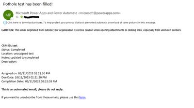

output looks like this

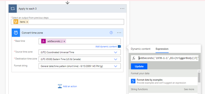

I am new to power automate. I am try to send email when feature is updated. I'm able to get most of flow working, but I am stucked on date formatting. As part of dymanic content I would like to include 'CreationDate' field, but I keep getting and error;
'Unable to process template language expressions in action 'Convert_time_zone' inputs at line '0' and column '0': 'The template language function 'Div' expects its first parameter to be an integer or a decimal number. The provided value is of type 'Null'.'
This is the expression I put into Convert Time Zone widget
addSeconds('1970-1-1', Div(triggerBody()?['feature']?['attributes']?['CreationDate'], 1000))

This works for me:
convertTimeZone(addSeconds('1970-1-1', Div(items('Apply_to_each_2')?['Attributes/CreationDate'],1000),'MM/dd/yyyy hh:mm:ss tt'),'UTC','Central Standard Time','MM/dd/yyyy hh:mm:ss tt')
NataliyaLys
Thank you @SarahRijneke your expression worked for me.
LaurenMiller
Hello @SarahRijneke - could you explain what 'Apply_to_each_2' refers to in your expression? Thanks!
