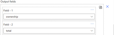

Select Output Fields
Users can now specify exactly which fields are returned in their query results. This improvement streamlines outputs, reduces unnecessary data, and enhances overall performance by reducing amount of data returned from the feature service.

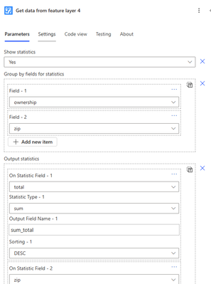

Output Summary Statistics
Users can now perform advanced operations by output summary statistics for any chosen fields within a feature layer. Furthermore, it is possible to select group-by-fields for these statistics, allowing for aggregation and the highlighting of key metrics. This enhancement simplifies the process of notifying stakeholders or updating dashboards with essential summary data, such as totals, averages, and counts, all without the need for external data processing. You will first need to select Yes to dropdown under Show statistics to run this operation. Choosing this will ignore some of the settings in other dropdowns. See the Query operation details mentioned in the URL above.
Here is an example:
