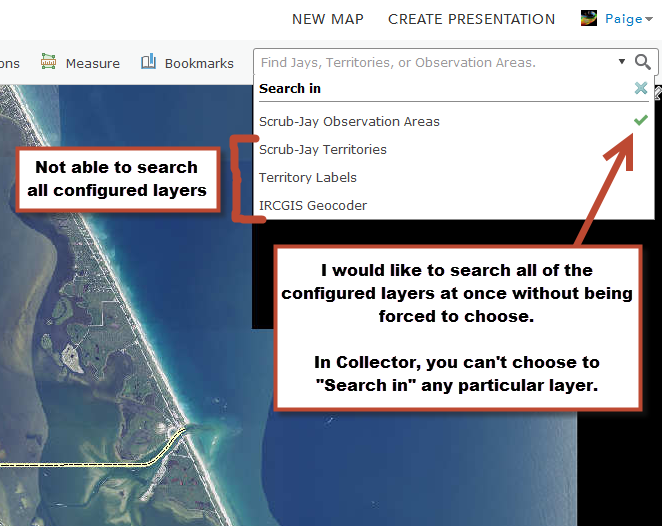

I am using a web map in AGOL for Collector. I have my web map configured to search in specific fields in three different layers in the map. In the web map on my desktop, I have to select a single layer to search on instead of being able to type anything in to search all of the layers at once. If I have to choose only one layer to search on, then why am I given the option to add more layers? I need data collectors to be able to search all of the layers in the Collector app. Russ, can you help?6-17-2015 10-35-45 AM.png

Collector will search all the layers instead of specifying particular layer

In the next update of AGOL you will be able to search across all. In Collector the search already searches across all Feature Searches configured in the web map. The app will however only work against 1 geocoder configured in your org/portal
