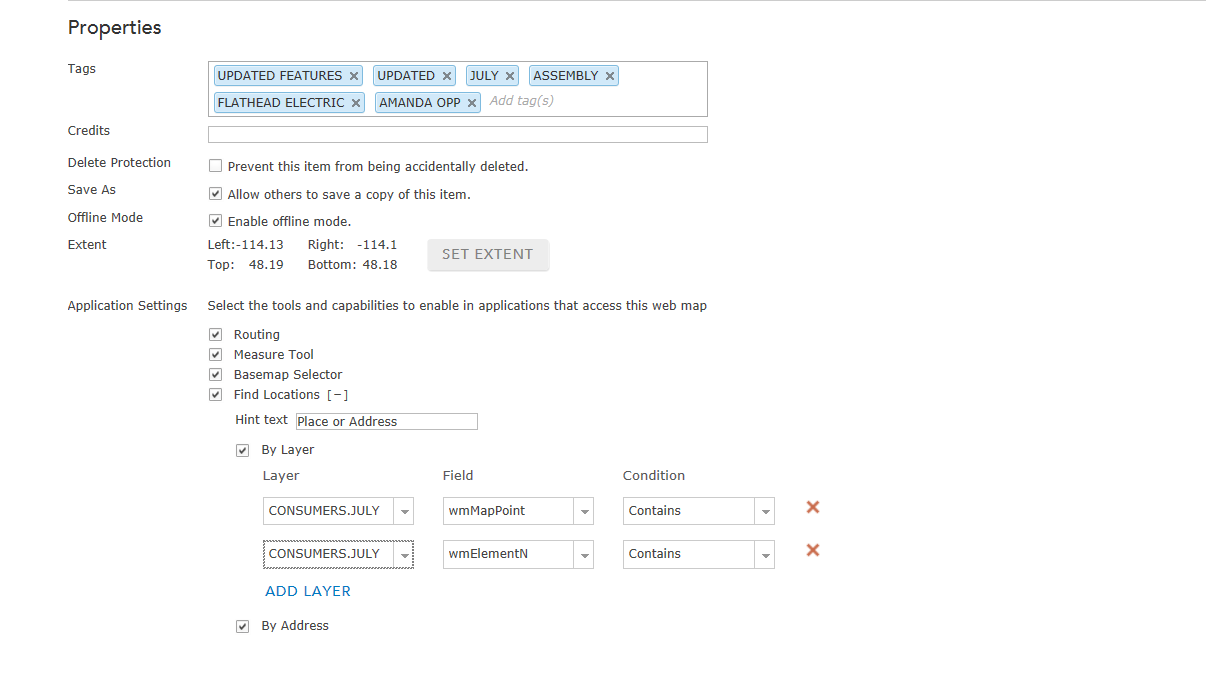

I have a very basic ArcGIS Online Map that I am using with Collector.  When I download my map for use in Collector I attempt to search for attributes that are known to be available in the features within the extent I have downloaded.  I have yet to get a search result using even the most basic of information. Any help would be appreciated.

I have my search set up to look at a layer. I search for a location number of a pole in our system.  It still doesn't like it.   I started a group where I have shared the map that we are using in the field and have sent you an invite to join the group.  The group is called "FEC Answers Group".  Any help is appreciated!  Thanks!

I am able to reproduce the issue you are seeing with your services in the web map as well and it looks like an issue with the JSON that is being written out when the map is saved. Can you please keep the map and services around while the AGOL team looks into the issue. I will send you an update when the issue has been addressed.

This will be fixed in the upcoming update to AGOL. Re-saving the map should pick up the fix after the update to online.
