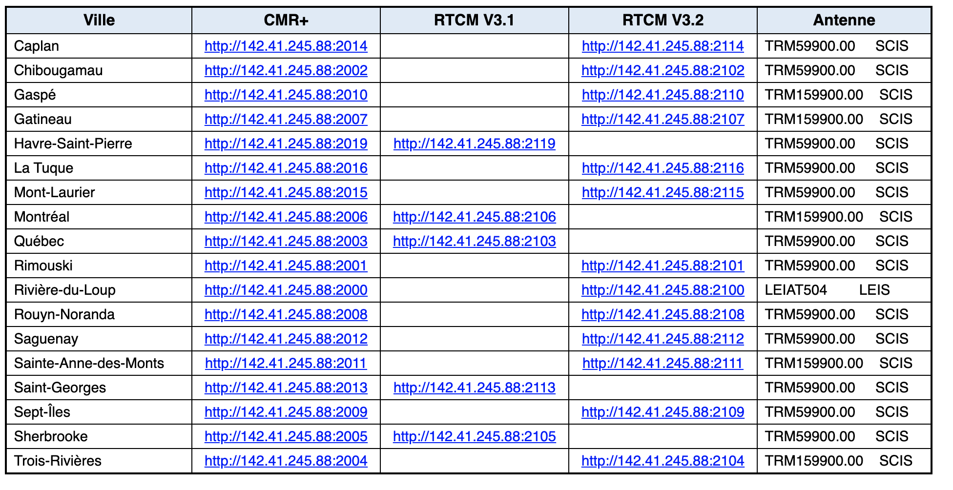

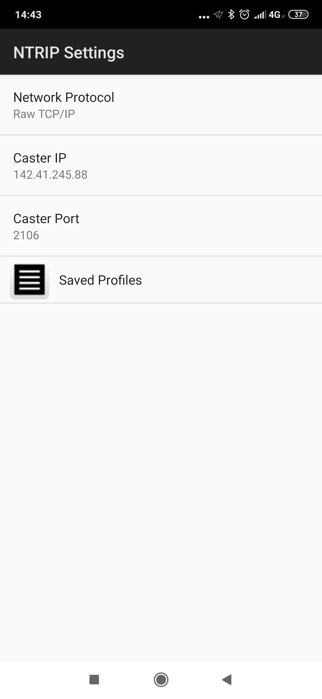

When I tested the connection, I used a Raw TCP/IP connection so I had no login credentials. I used the reference table below for the IP adresses/ports and selected the Data Stream format accordingly.
I will try using different login credentials to see if it fixes my issue. Thanks!

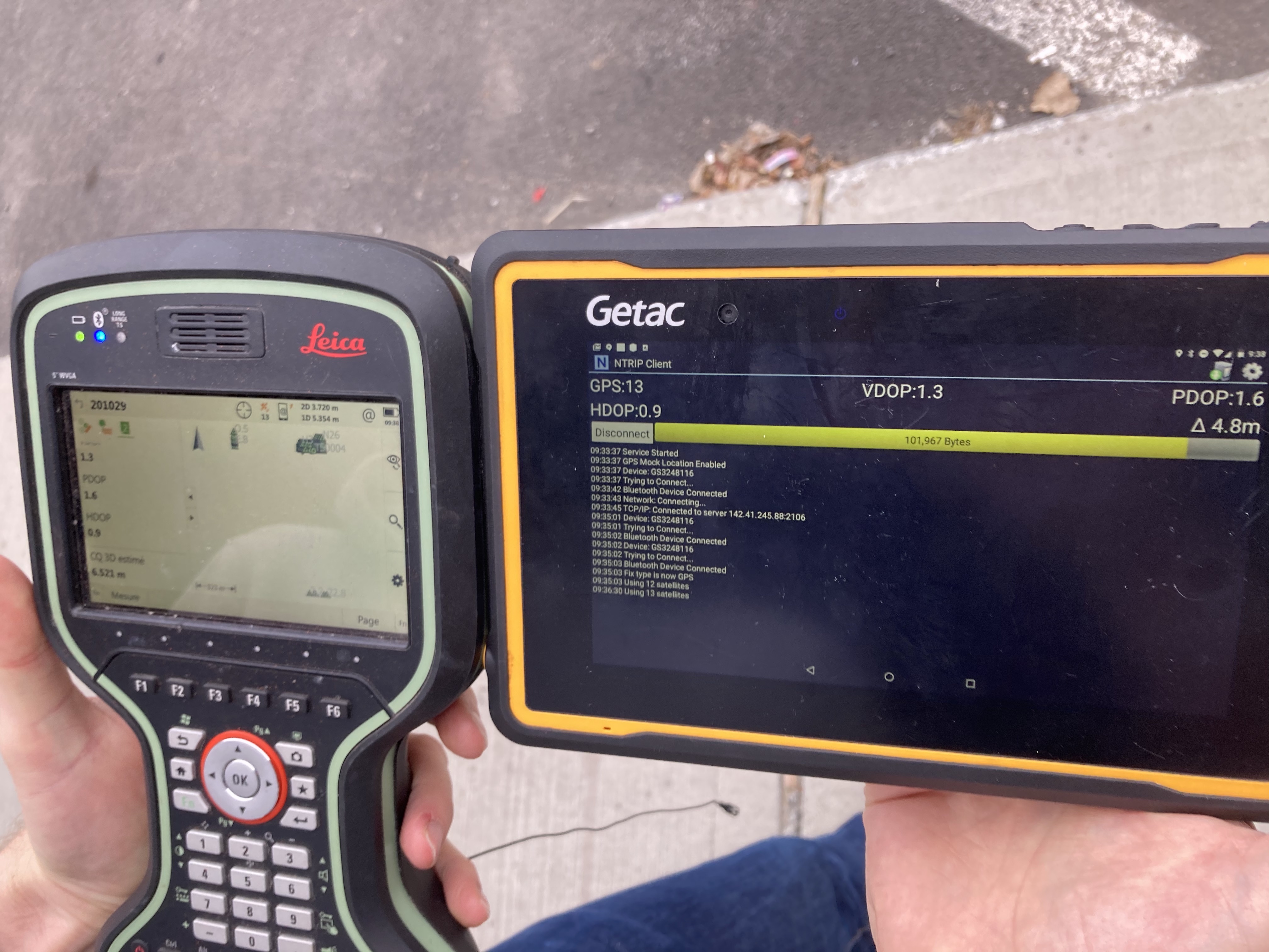

M Torres Good news! I am now receiving NMEA sentences when using a Raw TCP/IP connection for both the receiver and the NTRIP app. I can validate that the information on NTrip Client App by Lefebure is correct because I see the same data on the collector and the tablet (see attachment).
My goal is to collect high accuracy point with either ArcGIS Collector or Survey123 so I enabled 'Mock Up Locations' on my Android tablet so that the NTrip Client data can be used by those apps. However, I can not seem to access all the data from the NMEA sentences (vdop, pdop, hdop, etc).
