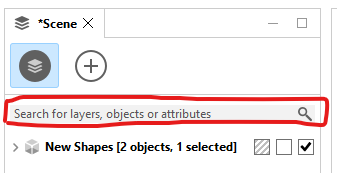

While its true that currently advanced selections based on attributes can be done using the python scripting interface only, a basic search for attributes is available directly in the Scene Editor:
For more details about the feature checkout the online help:
CityEngine Help: Scene Editor: Additional layer options
If you are interested in advanced search capabilities through a GUI interface, I encourage you to create a new post in the Ideas forum!

JonasObertuefer
I wouldn't say its unnecessary because you can do advanced filtering and selection using python. For instance using your script you can search for specific key/value pairs while the search bar in the Scene Editor will match everything with the entered name.
