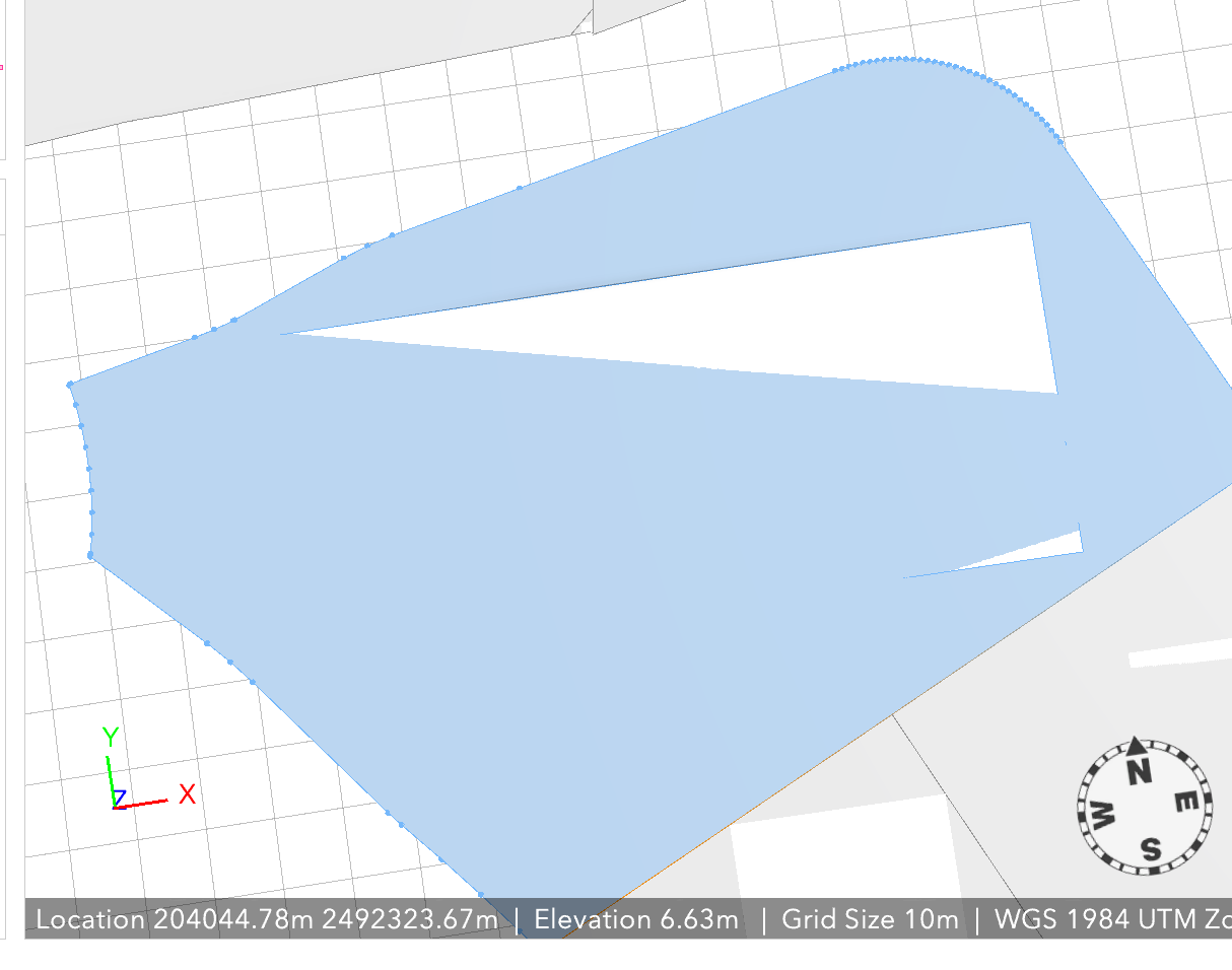

Hello, I'm working with calculating the distance between the shapes. To achieve that, I need to know the location data of each shape. It can be shown in the information display bar (for example, as the following figure shows, the shape center location is 204044.78, 2492323.67). But, how can I report and export it by CGA file?PingHe_0-1660552379443.png

Hi @PingHe ,
You can access this info for each initial shape in CGA from the initialShape attribute.
Best,
