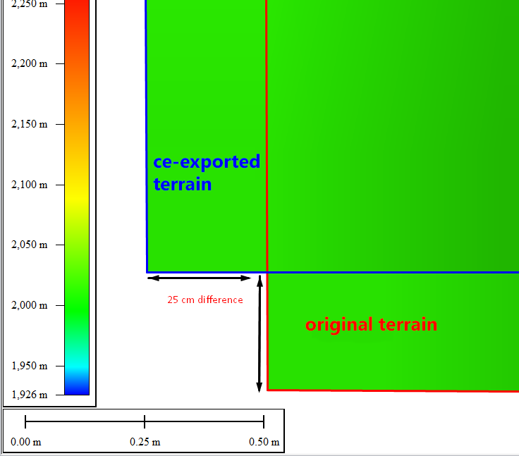

Hi,
I'm having problem exporting terrain elevation as an image/heightmap (tif 32bit) - the exported image from cityengine is shifted by approx 25cm to the left and to the top compared to the original heightmap as shown on the picture below (screenshot from globalmapper)

then I changed terrain resolution from 1024x1024 to 2000x2000px and exported this terrain from CE to 32bit tif and load it alongside the original terrain an I get this difference (as shown on the first image)
to double-check this problem, I also loaded the newly-exported terrain into cityengine and I can confirm that this terrain has different coordinates then the orignal one
                            (ce-exported terrain properties)
I can also visually confirm in CE that the original and exported terran don't match:
Am I doing something wrong? or can anybody confirm that this is a bug?

ThomasFuchs
Seems like CityEngine writes out a wrong world file not taking into account the center of the first pixel.
Reference: World files for raster datasets—ArcGIS Pro | ArcGIS Desktop
I've filed a bug report.
As a workaround the offset to the pixel center needs to be corrected manually:
CityEngine world file:
0.500000000000000
0.000000000000000
0.000000000000000
-0.500000000000000
300000.000000000000000
5001000.000000000000000
Corrected:
0.500000000000000
0.000000000000000
0.000000000000000
-0.500000000000000
300000.250000000000000
5000999.750000000000000

MarekDekys
Hi Thomas,
thanks for bug confirmation
I tested your workaround and it solves this problem
thank you very much
