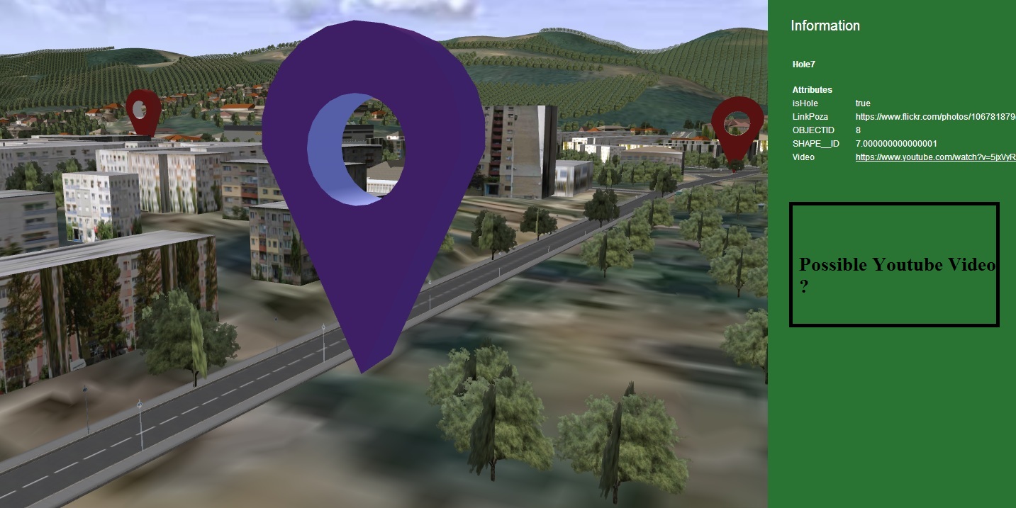

I have a question regarding embed a youtube video into WebScene. I have some points that have a text type attribute field populated with youtube URL`s.
When in WebScene I click one of those points, in the right part appears the attributes (see print attached). After I click the URL from the point selected, a new tab will appear redirecting to Youtube due to URL. What I want is to appear the video intro the WebScene and not to open a new tab to Youtube.

yeah its possible to.Instead of writing the url as just an attribute. Iframe it within the information tab. But wat i cant seem to make the video do is play full screen.
Make an object attribute in city engine with one model clicked.
Give it a name and make sure the type is STR
Then for the value input a code like this one.
<iframe width="560" height="315" src="http://www.youtube.com/embed/jofNR_WkoCE" allowfullscreen></iframe>

Yes this is it !! Another option what I did was changing the attribute in ArcMap. Instead of URL I copied the embed text. I will test this right now.
