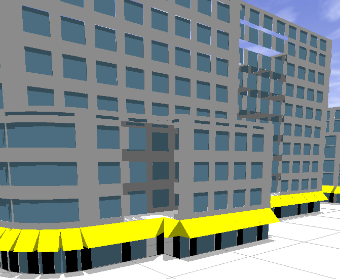

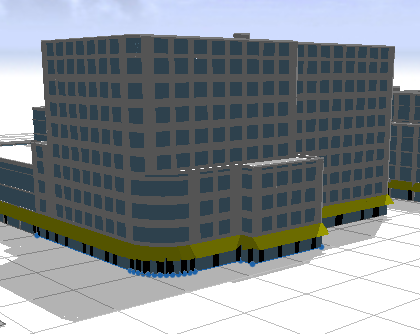

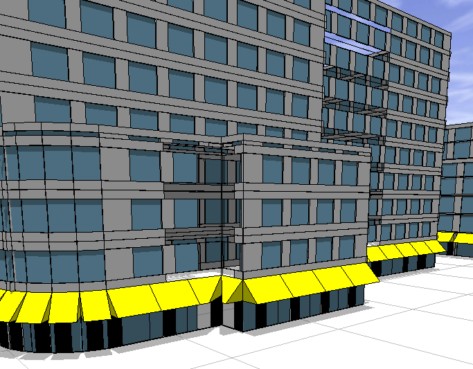

Are there any resources or help files for using the builtin.cube? I'm trying to give a building a little texture by recessing the builtin.cube into my facade, and it works fine except for the corners where the two cubes touch each other and then disappear all together. I'm open to another way to achieve the same look. Some advise on the awnings would be nice too. They're also created with the builtin.cube then with a shed roof applied to them.
The image below is a flat, but it all looks good, just lacks some texture
You can see on the images below the faces disappear once the cube is introduced to push them back.

Hi Devin,
that may be a couple different things..
- trim planes
- split operation bug (small chances)
- unfortunate CGA code
can you post some CGA code how you create those windows ?
DevinLavigne
Thanks Matt. It was some of first code I've written. I'll try cleaning up the code and if that doesn't work I'll post it.
