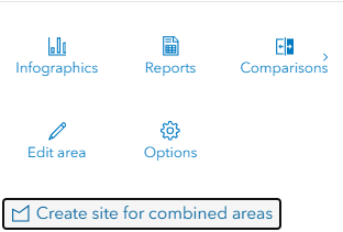

  • Select the sites you would like to run reports on, choose create site from combine areas option, and run reports or infographics on the combined site.

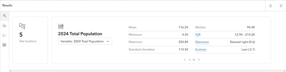

  • Use the Benchmark Comparisons workflow. You can view summary statistics for the sites in the result panel's summary tab. However, please note that these statistics are not exportable at the moment.
