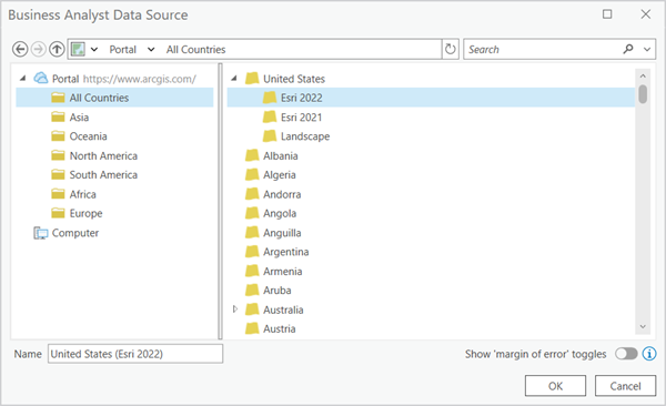

Business Analyst users of ArcGIS Pro and ArcMap can connect to this dataset now by signing into ArcGIS.com and selecting United States: Esri 2022.
As illustrated in the image above, the U.S. Esri 2021 dataset continues to be available for selection on ArcGIS.com. This "past year" dataset remains available to provide a transition period to migrate workflows, trade areas and other geographic data to the significantly changed U.S. Business Analyst 2022 dataset, based on Census 2020 boundaries.
The U.S. Esri 2021 dataset is based on the older Census 2010 boundaries. Therefore, the need to ensure that your standard geography trade areas match the boundaries of the Business Analyst dataset in use, is bi-directional.

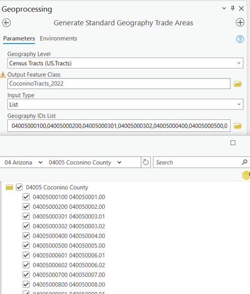

You can run the Generate Standard Geography Trade Areas tool, from the Trade Areas toolbox of the Business Analyst toolset in ArcGIS Pro, to re-create your standard geography trade areas. Our recommendation is to add the dataset year that the trade areas are built from, to the Output Feature Class name.
