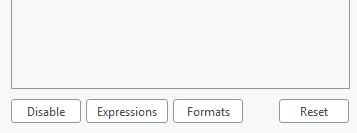

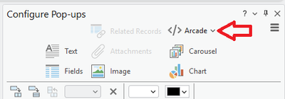

@ZachBodenner I apologize.  I completely misunderstood how to use an Arcade Text Template (the one in the image below).  Your solution was actually the correct solution.
I thought first I had to create an {expression} and then call that expression using the above Arcade Text Template.  This solution helped clarify what you were trying to point out.
I tested in a web map and it actually works now.
Everything goes into the Arcade Text Template (not in the Expressions section as I was trying to do).

To sum, if you want to use expression values inside an html and pass it to your popup, don't use the Expression button below and try to pass it to a configured popup.  Instead, use the Arcade button pointed to above.
