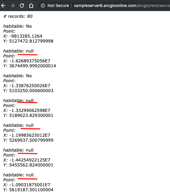

ErwinSoekianto
Esri Alum
The error I am getting in the console log when running the code you provided in the Update Attribute sample is
Error: Cannot assign [undefined] to QString
And when we query on the feature layer, some of the value on the "habitable" attribute on the features are null, so that's why it is returning "undefined"
We just need to handle this undefined properly when using QML String property or use the Javascript variable instead.
I tested by changing to use Javascript variable and it works,
var varhabitable = selectedFeature.attributes.attributeValue("habitable");

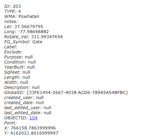

jaykapalczynski
Honored Contributor
Yea I am really confused right now.....I am sure that there is a value in every "WMA" field
I changed the variable to the vardamagetype and it works....but any other attribute in the service does NOT work...
var vardamageType = selectedFeature.attributes.attributeValue("TYPE");
// var varWMA = selectedFeature.attributes.attributeValue("FG_Symbol");
damageComboBox.currentIndex = featAttributes.indexOf(vardamageType);
damageTextField.text = vardamageType ;
The above gives me the same value ...one in the combobox and the other in the TextField

jaykapalczynski
Honored Contributor
just not sure where the Console.log returns the value while in QT Creator....See my post below about running in QT Creator and the two errors I am getting "undefined"  But am positive there are values in those fields.
var varWMA = selectedFeature.attributes.attributeValue("WMA");
var varFGSymbol = selectedFeature.attributes.attributeValue("FG_Symbol");
// set the combo box's default value
damageWMA.text = varWMA;
damageFGSymbol.text = varFGSymbol;
The first works the next two do not...BUT there are values in the WMA and FG_Symbol Fields.
