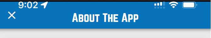

Hey all,
I am creating an app using the MapTour template. I noticed when I view this app on an iPhone 13, the top of the app goes behind the status bar rather than being placed below the status bar. This happens on every page of the app and makes any button that is at the top of the app (i.e. menu) inaccessible.
This doesn't occur on any iPhone below a 13 and I can't recreate the issue on an Android. This issue also happens when using the newest MapTour Template (5.2).
The Status Bar setting is toggled on in the Device Settings within AppStudio.
Is there somewhere in the code that I can make a change that will push the app below the status bar?
Thanks!
