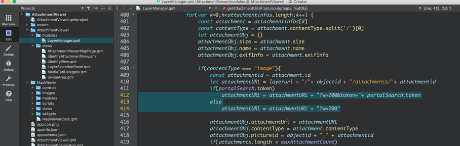

Hi Robert,
Thank you for your interest in the Attachment Viewer template.
This is by design to optimize the performance.
However, you can change the image resolution in the code based on your need.  To do this,
1. Select Attachment Viewer app in Desktop and open in Qt Creator (Click on Edit icon on side panel)
2. Navigate to AttachmentViewer/modules/LayerManager.qml file
3. Go to line 412 and 414, and replace 200 with a higher number such as 400, 600 or even 800 (Please test in mobile devices to find the best value)
"?w=200&token="
I hope this helps.
