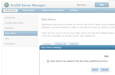

EDIT: The box is checked that allows data to be copied to the Portal when publishing.

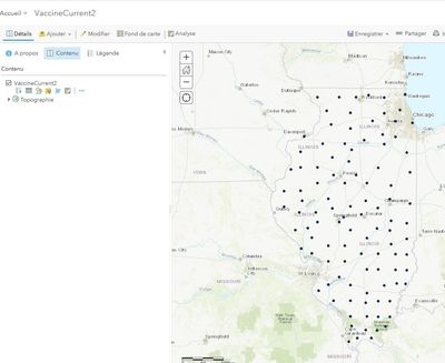

It's strange because from ArcGIS Pro 2.7.2 on my environment there is no problem.
See result below:
