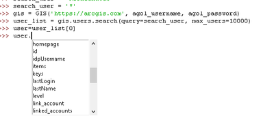

I am not good at finding documentation for these types of things (or, the docs barely exist) so I just tested it to see what properties were availalbe for users.
Basically, I used the piece of code you have above (in IDLE) to get a list of the users:
users = arcgis.gis.UserManager(gis)
then I just grabbed a single user from the list (this grabs the first user):
user = users[0]
Then, I use the IDLE code suggestions (hold windows key and press spacebar after the . ) to find the available properties, and scrolled down until I saw lastLogin.
Once I knew the property I was after was called lastLogin, I did Google search for "ESRI lastLogin" to find info/examples of how to use it.
