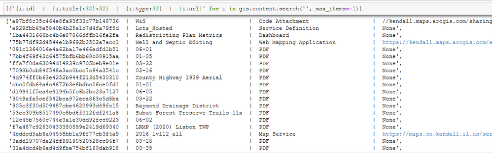

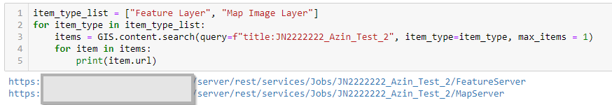

to get the URL address of a feature/map layer in ArcGIS Enterprise I am using this code and it returns what I need. (Rest endpoint URLs of the service)

The url property is specific to certain kinds of items, and will not always appear for each item. Though it does not seem to be documented, I would guess that the property is just inherited from the specific item type.
There was another post some time ago about another sometimes-present property that was undocumented, though which one it was escapes me currently.
Regardless, it's important to keep in mind that while the API docs are an excellent reference, they are by no means 100% comprehensive and without error. Which is usually the case for large, complex projects that are continually in a state of development.
If you spot what you believe is a gap in the docs, you should file a bug report at the Python API's github repo. Or, if you're knowledgeable enough, submit a Pull Request for the fix yourself!
