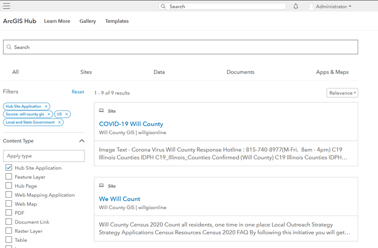

Ok, let's try another way. Can you access these nine Hub Site Applications listed on https://hub.arcgis.com via the Python API?
ManushiMajumdar
Yes, since they are of type `Hub Site Application` you can also access them using  Hub's Python API. Look at the examples in the repository for guides on how to do it. For non Hub item types you can use the Python API.
