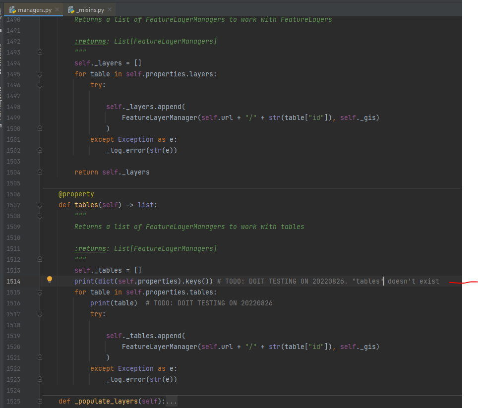

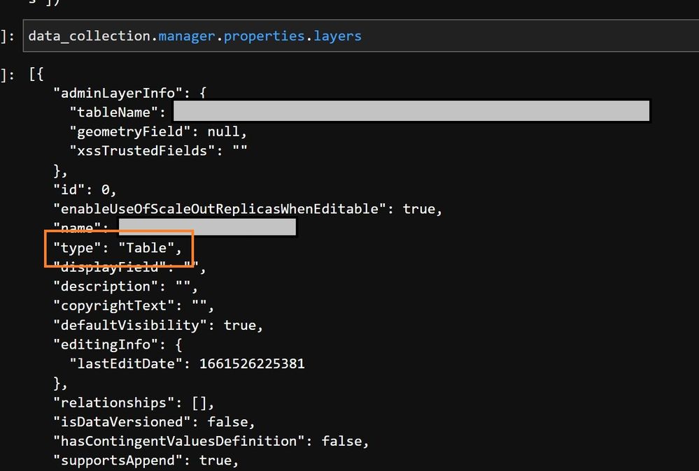

ConradSchaefer__DOIT_
In a Jupyter Notebook, looking at the .manager.properties.layers I can see there is a table item, which you would think would be in the .manager.properties.tables instead. Anyway, if you alter the @property tables function to use self.properties.layers (like the @properties layers function)instead of self.properties.tables then you make it through the issue. BUT I exited and did not let it go further because I didn't want this to alter a production asset and take a bad turn.
Here is a screenshot of the ESRI code altered as described above...
We too are now having an issue. Not sure when it began, our process was silently failing and log file repository only goes back a few weeks. I know that it once worked and something has changed.
We are overwriting a hosted table from a csv using the ArcGIS API for Python. Version 2.0.0 as of now
Here is our traceback with some paths obscured with XXX's and ZZZ's
File "XXXXXXX", line 305, in <module>
main()
File "XXXXXXX", line 296, in main
result = data_collection.manager.overwrite(output_csv_path) # Expects csv named same as csv_name variable
File "ZZZZZZZ\Python37\lib\site-packages\arcgis\features\managers.py", line 2326, in overwrite
for table in self.tables:
File "ZZZZZZZ\Python37\lib\site-packages\arcgis\features\managers.py", line 1514, in tables
for table in self.properties.tables:
File "ZZZZZZZ\Python37\lib\site-packages\arcgis\_impl\common\_mixins.py", line 84, in __getattr__
cls=self.__class__.__name__, name=key
AttributeError: 'PropertyMap' instance has no attribute 'tables'
Our code from which this error arises is below. The overwrite() step is where the failure occurs.
hosted_table_item = gis.content.get(itemid=config_parser["AGOL"]["hosted_table_item_id"])
data_collection = arcgis.features.FeatureLayerCollection.fromitem(hosted_table_item)
Looking at it further, it seems under the hood that the "tables" key doesn't exist in the collection properties but is expected to be there.
However, for the property just above for layers, the self.properties does have a 'layers' key.
Here is the print out from the keys() call. You will see "layers" as the last key but there is no "tables" key. I think that is either the AGOL side missing a "tables" key or the code not accomodating/adding it??
dict_keys(['adminServiceInfo', 'enforceFieldVisibility', 'currentVersion', 'serviceItemId', 'serviceDescription', 'hasVersionedData', 'supportsDisconnectedEditing', 'hasStaticData', 'hasSharedDomains', 'maxRecordCount', 'supportedQueryFormats', 'supportsVCSProjection', 'supportedExportFormats', 'capabilities', 'description', 'copyrightText', 'initialExtent', 'fullExtent', 'allowGeometryUpdates', 'units', 'supportsAppend', 'supportsSharedDomains', 'supportsWebHooks', 'supportsTemporalLayers', 'layerOverridesEnabled', 'size', 'syncEnabled', 'supportsApplyEditsWithGlobalIds', 'supportsReturnDeleteResults', 'supportsLayerOverrides', 'supportsTilesAndBasicQueriesMode', 'supportsQueryContingentValues', 'supportedContingentValuesFormats', 'supportsContingentValuesJson', 'advancedEditingCapabilities', 'editorTrackingInfo', 'xssPreventionInfo', 'layers'])
Thanks
