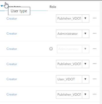

I am expecting the name of my Roles as seen below... they are custom roles and I need that to eventually set them up..
How do I get the UserName, UserType, UserRole, UserEmail???

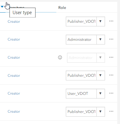

I need a list of the UserName, LastName, Email, userType, Role as seen in the image below.
AND A LIST that I could be able to user to come back and create, modify or delete these users in AGOL.
  1. John, Smith, [email protected], (Creator/Field Worker), (custom Role name)
  • The problem is I can get a proper listing of Roles and Custom Roles with gis.users.roles.all but that is just a list of available user Roles.  I need them listed for each user.
  • If I search for users I can only get meaningless data with gis.users.search(query=search_user, max_users=2000)
    • This is all I can seem to get by using these:
    • item.username, item.role, item.roleId, item.userLicenseTypeId, item.level, item.email
    • ex.  users name, org_user/org_admin, 4uTOULA5tZCrtkZs, creatorUT/fieldWorkerUT, 11 or 2, email
org_user or org_admin does not tell me the users Role name which is a custom name.  Getting a list from gis.users.roles.all is worthless because it’s just a list of available Roles and NOT user specific.
It appears that what is being stored in AGOL User store is NOT what I am seeing in my original post.
  • I see Creator or Mobile Worker but when I query for this data I get CreatorUT or FIeldWorkerUT
  • I see my my Custom Roles in the dropdown but when I query I get org_user or org_admin.
