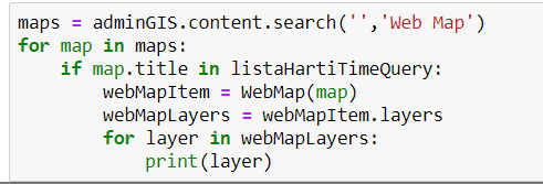

I`m at the step where I iterate through my layers from my map but I cannot find the solution to apply a filter/definition query to them.

I`ve managed to iterate through layers in the webmap, and for each one, I`ve replace it with the same, just that I applied the definitionExpression on it; something like this:
for layer in webMapLayers:
   layerTitle = layer.title
   srcResults = adminGIS.content.search(layerTitle)
   featCollection = srcResults[0]
   sql = "sql filter"
   webMapItem.remove_layer(layer)
   webMapItem.add_layer(featCollection)
   webMapItem.layers[0]['layerDefinition']['definitionExpression'] = sql
   webMapItem.update()
