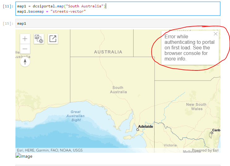

Hello folks

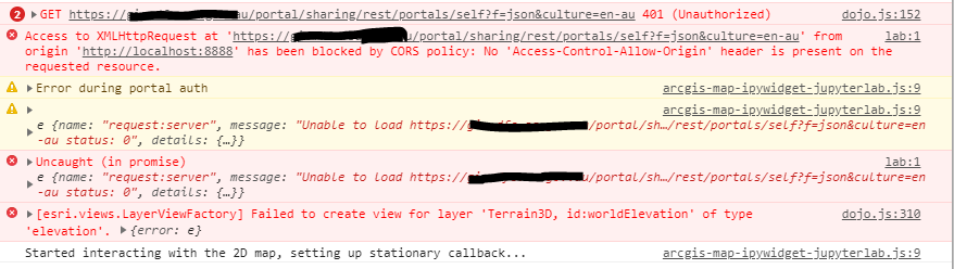

Have you seen this annoying message when displaying a map in the Jupyter Lab/notebook:
In the browser console:
My GIS environment is ArcGIS Portal 10.6 with federated ArcGIS servers, IWA authentication.
If I connect to AGOL, there will be no warnings. So I think my jupyter environment should be fine, it's on the GIS side...
All advises and comments are welcome

simo xu‌ In regards to your error message in the map widget: Does your Enterprise have CORs enabled? Are you using the most up-to-date Python API? I've tested the most recent Enterprise against the most recent Python API and the CORs is working fine in my case, but there are a lot of moving parts for web authentication.
If you're looking for a quick workaround, serving your notebooks locally over https will provide a fix to any CORs issue. But it should be possible to interact with the notebook over http since ArcGIS Enterprise supports CORs.

We left all CORs settings in our portal and ArcGIS Servers to the default value, and according to ESRI document, the default settings should allow CORs.
I also tried to serve the notebook over https (using a self-signed certificate), but the warning on the map widget remains. plus, I can't add any hosted feature layer to the map widget either. and I am not sure if these symptoms are linked back to the same cause.

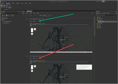

This may or may not be helpful... I experience this issue in ArcPro Notebook (i.e. not an ArcGIS Online Notebook). It seems that using "pro" auth in an ArcPro Notebook causes the issue (unclear why). Just using gis=GIS() results in no error message for me in ArcPro.
It doesn't solve my problem though, as I need to authenticate into my organization.
