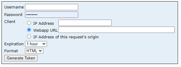

Clive_S
Hi David,
I thought that stated at the beginning of the post that if I create a Token using the Portal Form.GenerateToken.PNG
 Then use that token in the REST url.
json_file = url+token, this returns the JSON. The issue that I have is trying to generate a Token.
This returns the error message/s.
