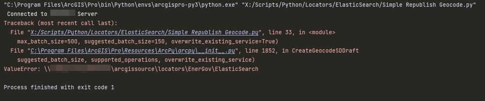

I have a script to overwrite an existing locator service, in a standalone ArcGIS Server (10.9.1) The code was originally shared by ArcGIS Geocoding Team here
I'm getting the following error when creating the sd draft file
I already checked and all my paths are correct. Any ideas?

17 Replies
