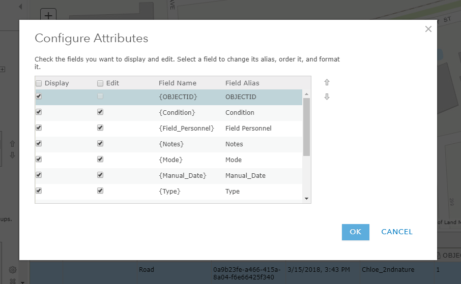

I am hoping to run a script that can hide certain fields from an ArcGIS Online web map.  In ArcGIS Online, I would accomplish this by opening a webmap, clicking the three dots of the layer I was interested in, selecting "configure pop-up" then selecting "Configure Attribute".  Finally from there I can edit the display options in the GUI shown below.
Is this something that is currently configurable from the ArcGIS API for Python?
