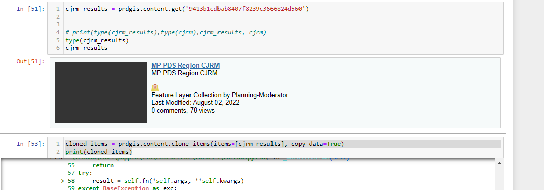

I'm trying to clone a Feature Layer Collection from one portal environment to another, and for some reason the dataset isn't being found because of the title property have random letters added. As you can see on the last line 116, the title of the item has been changed to "MP_PDS_Region_CJRM_32bc0"
cjrm_results = prdgis.content.get('9413b1cdbab8407f8239c3666824d560')
cloned_items = prdgis.content.clone_items(items=[cjrm_results], copy_data=True)
print(cloned_items)

_ItemCreateException: ('Failed to create Feature Service MP PDS Region CJRM: ERROR: Dataset not found.\n(Error Code: 500)', <Item title:"MP_PDS_Region_CJRM_32bc0" type:Feature Layer Collection owner:Planning-Moderator>)
It's recognizing the item prior to this:
Anybody know whatsa goin on here? Thanks.
