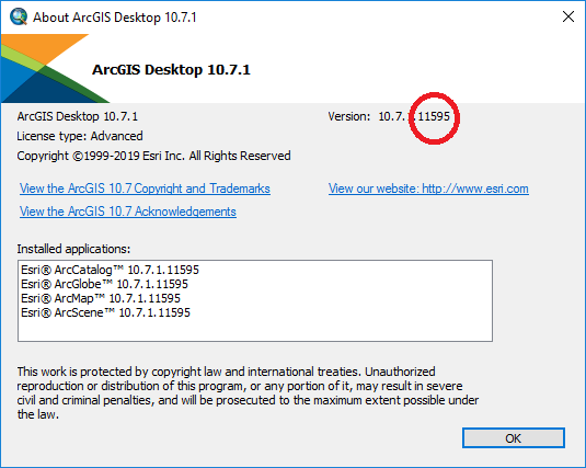

2. What is the build number for ArcMap? Launch ArcMap and go to Help->About ArcMap..

My physical machine is running the following:
- OS Windows 10
- ArcGIS Desktop 10.6.1 Build 9270
- Mapping and Charting Solutions Desktop 10.6.1 Patch 1 Build 997
The code that you have provided in its entirety executes without issue.
