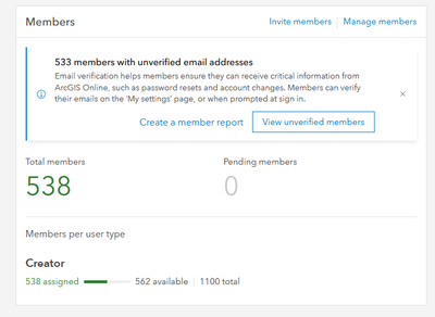

I'm attempting to access and manage users in our HUB community account with the python API. I'm using our only sign-in credentials.
gis = GIS("https://countyhub.maps.arcgis.com", "username", "password")

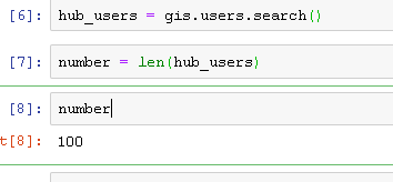

To get the number of members I use:
hub_users = gis.users.search()
number = len(hub_users)
number
#prints
100

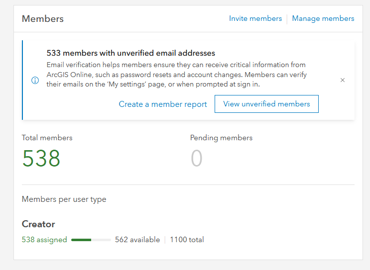

I don't know where it gets the 100? Our Members page says we have 538 enabled members with any sort of role.

Found out you have to utilize the UserManager class (with admin privileges).
This will get you a list which includes the count of users in your org:
from itertools import count
import arcgis
users = arcgis.gis.UserManager(gis)
totalUsers = users.counts(type='user_type', as_df=False)
totalUsers
#prints
[{'key': 'creatorUT', 'count': 538}]
#index it to pull out the integer
totalUsers = users.counts(type='user_type', as_df=False)[0]['count']
totalUsers
#prints
538
Credit goes to this SE answer. This answer has another useful line of code. It allows you to print out the names in a list.
allUsers = users.search(query=None, max_users=totalUsers)
allUsers

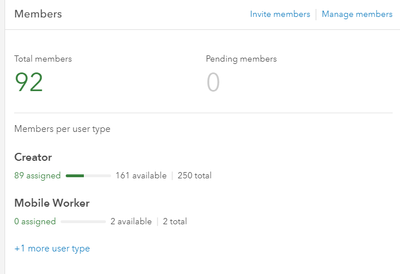

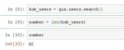

Don't know if there is some kind of limit that it will return as I only have 92 members in my Org.
Which is exactly what your code reports:

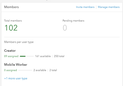

This was bothering me so I added some users and tested again.
For whatever reason, it does appear that the results are limited to 100 users:
RhettZufelt_0-1665067968188.pngRhettZufelt_0-1665067968188.pngRhettZufelt_1-1665067985479.pngRhettZufelt_1-1665067985479.png
