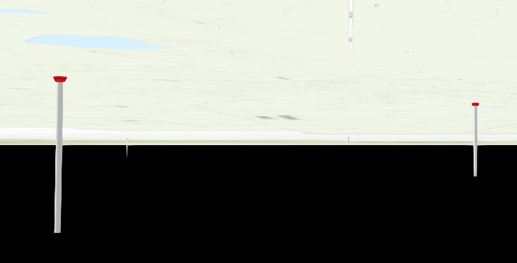

Hello,
I have been trying to build something very similar to this WebMap https://developers.arcgis.com/javascript/latest/sample-code/sandbox/index.html?sample=scene-local  using my own data, I have gotten most of it to work for myself except extruding my points to the right location.. Here is what my code is producing;
The points are sort of half n half on the surface and below, where I would like them to be displayed is right at the bottom of the well.I cant use a general offset because all the bottom of the wells are different depths, if there is a way I could offset the points by grabbing the value in that depth column that would work, but I am still new to this JavaScript API. I have pretty much used the same code as the one in that scene just with different parameters. here is the code;

SaschaBrunnerCH
Hi Adam
Do your data have z-values?
If not you can set the elevation with an Arcade Expression see the help FeatureLayer-elevationInfo. Or see in the chapter "Feature Z" in arcade guide.
With the following codesnippet you can see the 3d-points below the ground with -1000 meters:
          elevationInfo: {
            mode: "relative-to-ground",
            featureExpressionInfo: {
              expression: "-1000"

AdamThompson3
Hey Sascha,
Thanks for the reply! That was exactly it with the "HasZ" property on my shapefile, bit of a silly mistake but when I displayed the points through arcmap in "Add XY Data" I had forget to include that z field, all is working well now
