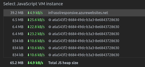

When I look at the memory tab I see:

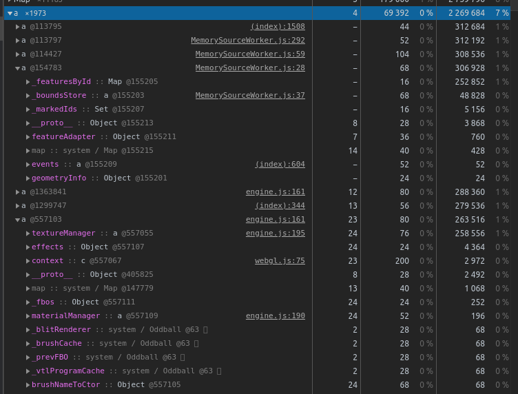

When I run a heap stack trace I see:
Among another objects.  Is there another way to assure the memory is getting freed?
