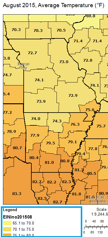

I have a map that’s showing a feature layer.  The feature layer has been symbolized in the code using a class breaks renderer.  I’ve also set up custom map templates and a custom print service, to have control over the details of how an exported map will look.  There are two things that I’m having trouble figuring out:
1 - In the exported map, the name of the feature class (also the layer name in the service) shows up in the legend…  I don’t want that there.  Interestingly, it does not show up in the Legend Dijit.  Just in an exported image.
2 - I’d like to know if there is a way to force the legend to display multiple columns, since I have a portrait layout and only 3 or 4 classes will fit in one column before the legend goes off the page.  Is there a setting somewhere in the renderer that I can use?  Do I set that up in the custom mxd?  It is saved with no layers in it, so I'm not sure how any settings I make there would carry through to when it's used with the print service.

Well, I have solved question number two, and it didn't even involve JavaScript.  I'm not sure how I missed this before. In my custom MXD, in the (blank) Legend's properties, on the Layout tab, there is a section in the lower right called Fitting Strategy.  I just checked the Fixed Frame box and then set the legend's available area (width/height) on the Size and Position tab.  Now the legend will make as many columns as it needs.
Side note - I found that if the legend items still won't fit in the area, it will only show the title.  I spent a while trying to figure out why my legend was empty, until I figured out I just needed to make my legend area larger.LegendSettings.png

Here's how the legend came out when one layer of my dynamic map service layer is showing:

Do you want the legend below the map the way you are showing it in the screenshot or would you rather have the legend on either the right or left side of the map?
ZoeZaloudek
In this case, I do want it on the bottom.  The image being created is only 6 inches wide by 8 inches tall (portrait).  I have another option set up as 8" wide x 6" tall (landscape) - for that one I just have the legend as one column on the right.
