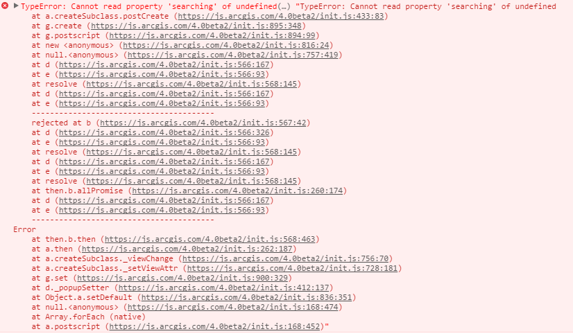

An application built by JS API 4.0 beta2 shows error message in console panel.
The error message is not shown when JS API 4.0 beta1 is used.
Steps to recreate:
1. Open a sample from sample code page.
2. Click 'Explorer in the sandbox' button.
3. Open console panel in developer tools. The error message is shown.
4. Change API from beta2 to beat1 and clear console.
5. Click 'RUN'. Check console panel. There is no error message.

I checked 4.0beta3 and I am getting an error.

In fact, the error message disappears when I change browser's language from Japanese to English.
So the issue is caused by using a browser in Japanese.

AyakoSUZUKI
New Contributor III
Hi, Bjorn
I deleted browser cache and tested with the sample you linked in beta3 on Firefox, Chrome and IE11.
Firefox did not show the error message related to searching property (it seems that different error message is shown thought), but the error message still appears on Chrome and IE11.
I took snapshots of console panel.
Firefox
Chrome
IE11
Translation for the message: "SCRIPT5007: Unable to get property 'searching' of undefined or null reference"
