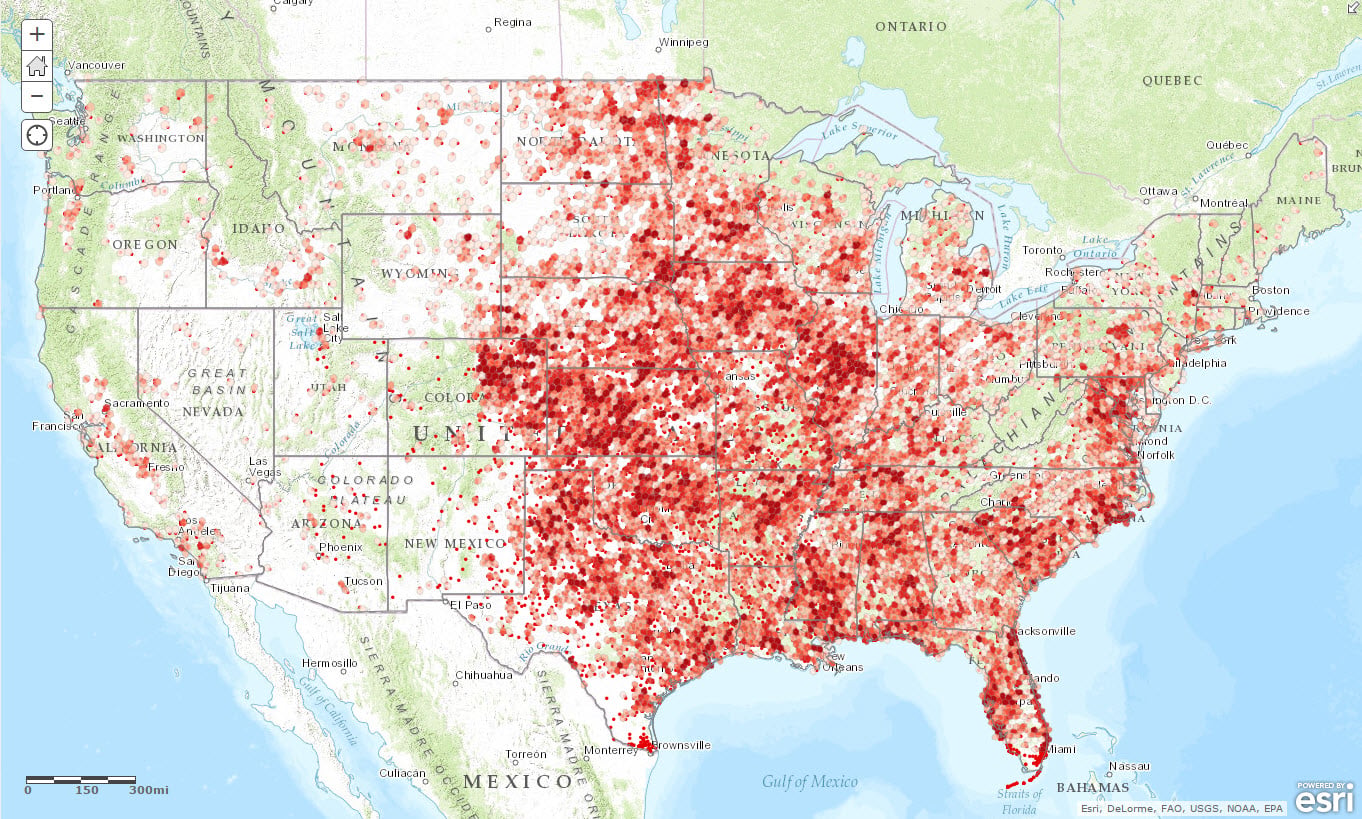

I have some huge number of GPS data which I want to plot on ArcGIS web map but in the form of hexagonal binning. The hexagons must be equal sized connected hexagons.
An example similar to my scenario I found on this link but it is for ArcGIS Desktop. See the snapshot below also.
I need to know how I can do that in latest version of ArcGIS API for Javascript 4.3.
Can someone please guide. Thanks.
Hexagonal Binning

As far as I know there's nothing exactly like this in the web tier.  This kind of thing is generally not done in the browser.
There is this: GitHub - nickcam/FlareClusterLayer: ArcGIS javascript custom graphics layer. Creates clusters and cr...  which might meet your specifications, but may be too slow with a large number of points.
However, the example you linked isn't for arcgis desktop, it uses the web map viewer in ArcGIS online/ArcGIS Portal.  Assuming your data is pulled in from a feature service, and you have access to AGOL/Portal, you should be able to follow the steps in that tutorial to get this effect.
The thing to note here is that this work is not done in the browser, it's done by creating a new feature service and using an aggregatePoints GP tool.  All of this takes place on the back-end.  Technically it would be possible to do this work in the client, but it would be fairly expensive and you wouldn't want to do it every time the map gets loaded,
