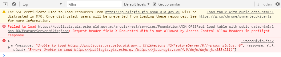

The error that I get is:
Any ideas? Did anyone get it to work?
Thanks!

<!DOCTYPE html>
