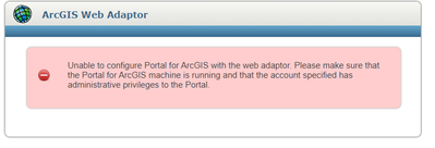

I have installed the 2nd web adaptor named wap and try configuring it to use the PORTAL
(See 1st image)
After successful completion of the operation I am getting the error:
"No portal is configured"
when browsing to
https://gis.axioma-in.com/wap/home
(See 2nd image)
Please please please help me ... what am I doing wrong ??
Thanks ahead and best wishes
Roy

I am having the same single-machine WA issue (10.7.1 on Win 10) and it is very frustrating. One difference...managed to get my machine name to finally show in Portal Admin Dir >  Registered Machines but I still get the "No Portal is Configured" error on the ArcGIS WebAdaptor screen as shown in Roy's original post. Any additional ideas to understand why there is no communication with WA-Portal would be appreciated.
Thanks in advance!

Sorry to bring this topic up again, but I am having the same issue: I lost connection to the server as I wanted to reinstall the web adaptor.
Now, whenever I want to configure the webportal, all I have is
I really need a help from you.
